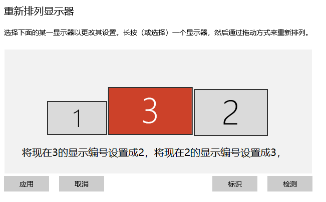

Win10,多屏显示问题,更改显示器编号
将现在3的显示编号设置成2,将现在2的显示编号设置成3,
求助大神,是否可以设置,
可以试试全部拔了 重新接线 但是 本身可以拖动排序的啊 改变数字有什么用处呢
工作需要,必须是显示序号以特定的方式排列,软件才可以使用。
如果软件不能设置序号,就只能插完显示器,后根据序号调物理位置。
谢谢

Even if the cables are switched Windows 10 will unfortunately still remember the monitor numbers as it looks like it’s using some monitor hardware identifier to attach the identity number. The only way I could find to change the monitor identities was the following.
If it’s a laptop, disconnect it from your dock or disconnect all monitors and use the laptop monitor for the following procedure. If you are using a desktop your mileage may vary but disconnect all monitors except #1. Delete the following entries from the registry. (Export them and back them up before you delete of course just in case something goes wrong)
HKEY_LOCAL_MACHINE\System\CurrentControlSet\Control\GraphicsDrivers\Configuration
HKEY_LOCAL_MACHINE\System\CurrentControlSet\Control\GraphicsDrivers\Connectivity
Shut down the machine, connect only the first monitor to the dock (or the machine) and switch the machine on. The monitor will be identified and added as monitor 1 back into the registry. Proceed to connect what you would like to be monitor 2 (and 3 and so forth) and they should be numbered properly.

谢谢,我回头试一试,是否可以。
试了下还是不行,请问现在有方案了吗?
