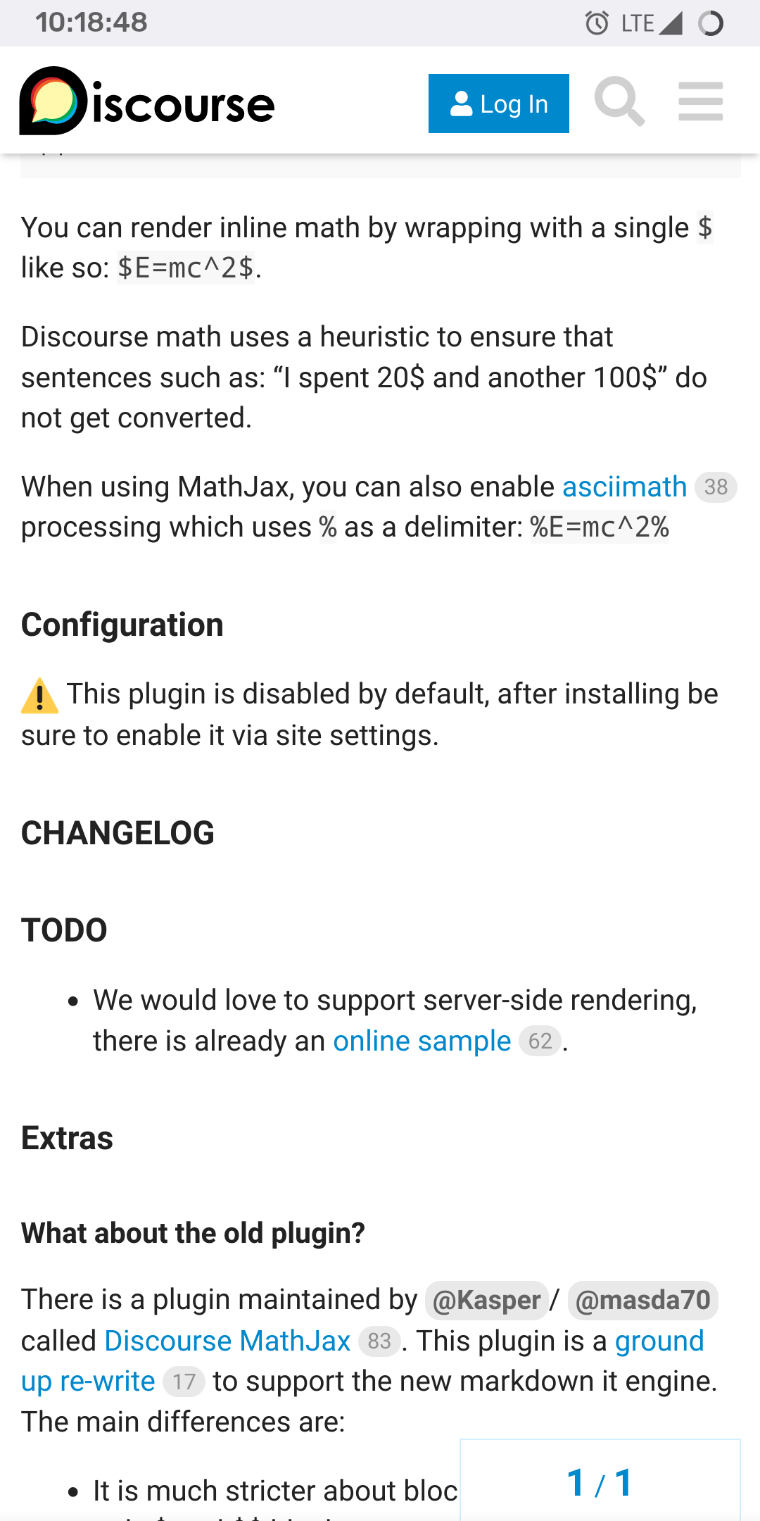

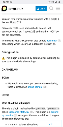

这是官网的插件介绍。下面的文字讨论了它跟老插件的区别。具体地说,在新插件里,只有 $ 与 $$ 能用。
What about the old plugin?
There is a plugin maintained by @Kasper/ @masda70 called Discourse MathJax . This plugin is a ground up re-write to support the new markdown it engine. The main differences are:
- It is much stricter about block and inline syntax, only $ and $$ blocks are supported
- It embeds MathJax or KaTeX renderer so you do not need to use a CDN
- It only loads the math renderer if it detects equations on the page.
- It surgically applies renderer as opposed to performing full page scans.
- It is well specified using specs
