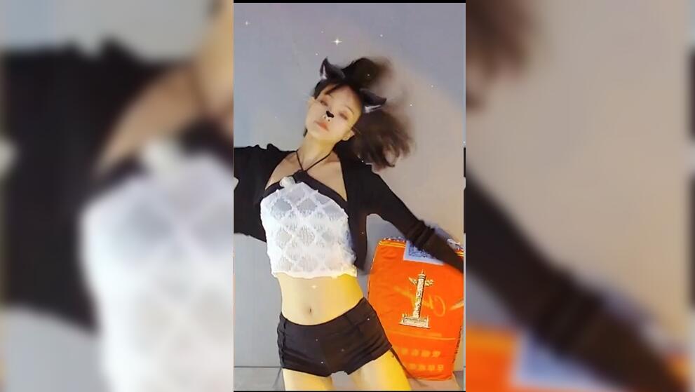

由于视频和屏幕长宽比不同,在不发生形变的前提下,为了避免黑边,我总结有这几种显示效果:
  1. 画幅裁切。放大画面,强制只显示和屏幕等宽的部分,超出的高度部分不显示。
  2. 横向复制画面。如图:
  3. 画幅裁切并垫底,添加模糊效果,上方居中叠加一层适应高度的画面
  4. 当然还可以继续叠buff,在3的基础上,对叠加的一层画面进行放大,令视频高度方向做一定程度的裁切

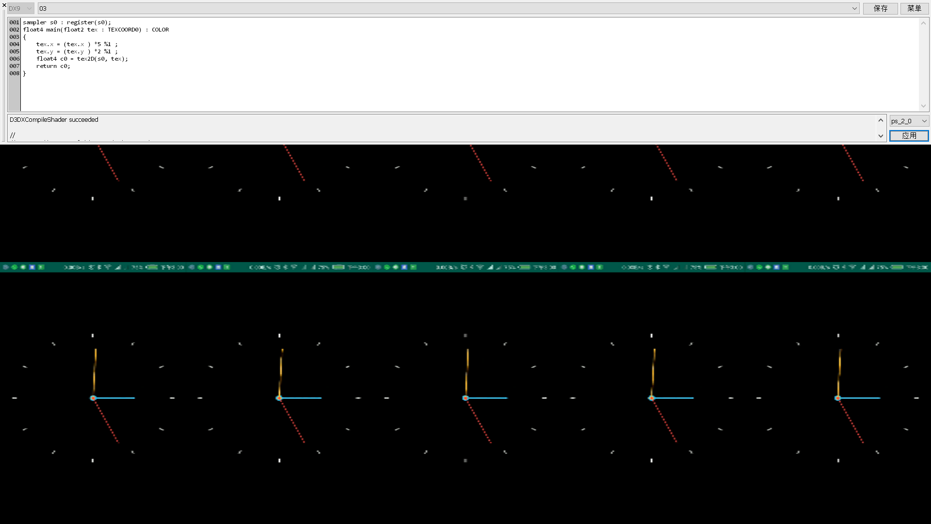

模式2: 在模式1的基础上(选择拉升模式),设置着色器:
sampler s0 : register(s0);
float4 main(float2 tex : TEXCOORD0) : COLOR
	tex.x = (tex.x ) *3 %1 ;
	float4 c0 = tex2D(s0, tex);
	return c0;
当然也可以修改tex.x = (tex.x ) *3 %1 ;为tex.x = (tex.x ) *任意数字 %1 ;实现其他效果。譬如

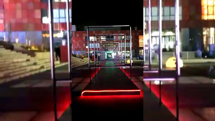

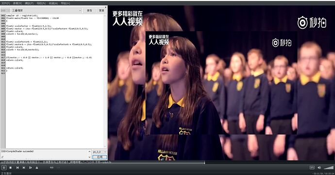

模式3也搞定了,主要还是靠抄
#define scale 3
float4 p0 : register(c0);
float4 p1 : register(c1);
#define width (p0[0])
#define height (p0[1])
#define counter (p0[2])
#define clock (p0[3])
#define one_over_width (p1[0])
#define one_over_height (p1[1])
#define PI acos(-1)
#define angleSteps 12
#define radiusSteps 10
#define minRadius (0.0/width)
#define maxRadius (10.0/width)
#define ampFactor 2.0
if( tex.x >= 0.5 - 0.5 / scale && tex.x <=  0.5 + 0.5 / scale ){
float2 scalefactor = float2(scale,1);
float2 newtex = (tex-float2(0.5,0.5))*scalefactor+ float2(0.5,0.5);
return tex2D(s0,newtex);
}else{
float2 scalefactor = float2(1,1.0/scale);
// return tex2D(s0,newtex);
	float4 c0 = tex2D(s0, newtex);
	float4 origColor = tex2D(s0, newtex);
	float4 accumulatedColor = {0,0,0,0};
	int totalSteps = radiusSteps * angleSteps;
	float angleDelta = (2 * PI) / angleSteps;
	float radiusDelta = (maxRadius - minRadius) / radiusSteps;
	for (int radiusStep = 0; radiusStep < radiusSteps; radiusStep++) {
		float radius = minRadius + radiusStep * radiusDelta;
		for (float angle=0; angle <(2*PI); angle += angleDelta) {
			float2 currentCoord;
			float xDiff = radius * cos(angle);
			float yDiff = radius * sin(angle);
			currentCoord = newtex + float2(xDiff, yDiff);
			float4 currentColor = tex2D(s0, currentCoord);
			float currentFraction = ((float)(radiusSteps+1 - radiusStep)) / (radiusSteps+1);
			accumulatedColor +=   currentFraction * currentColor / totalSteps;
	return accumulatedColor * ampFactor;
